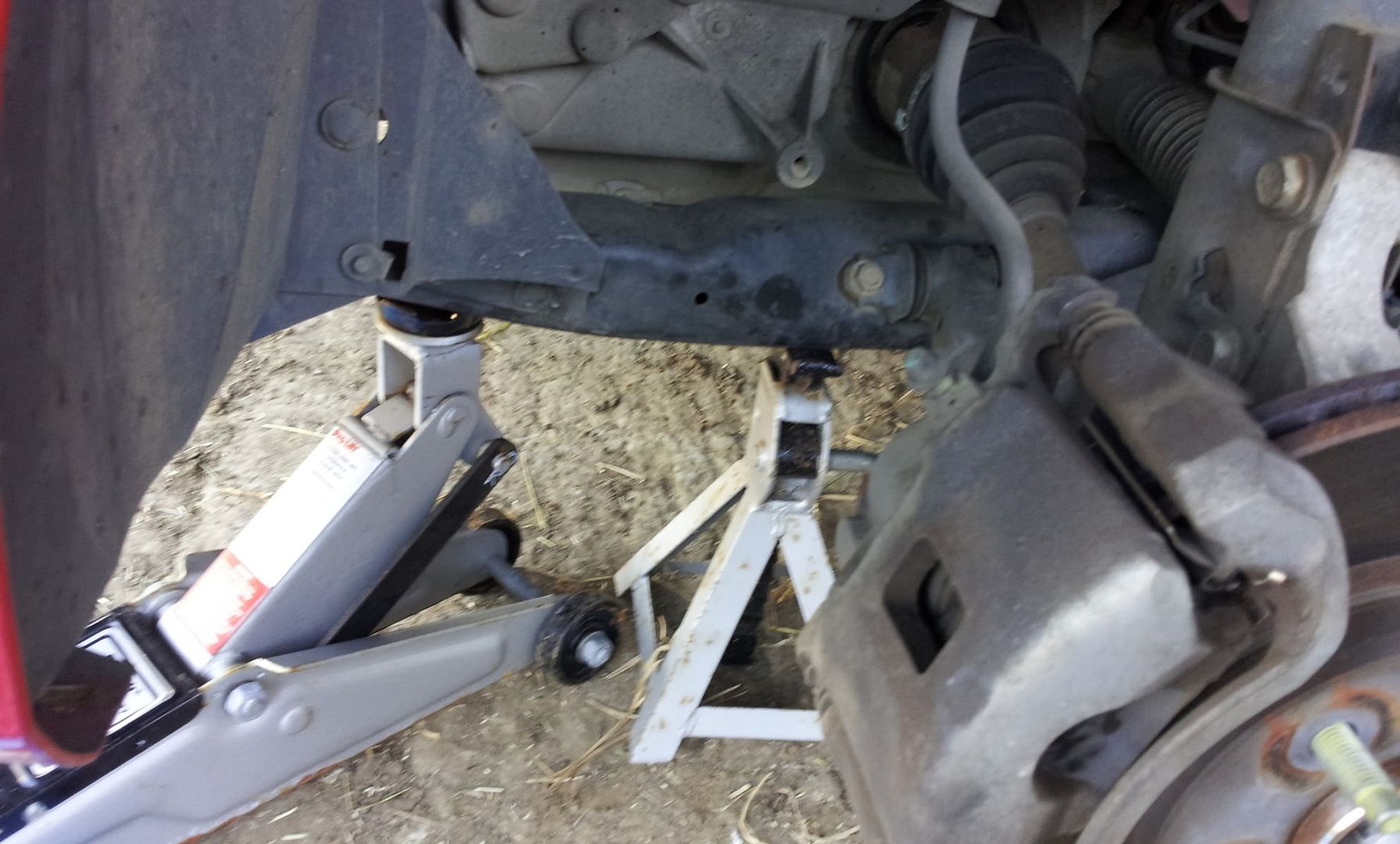

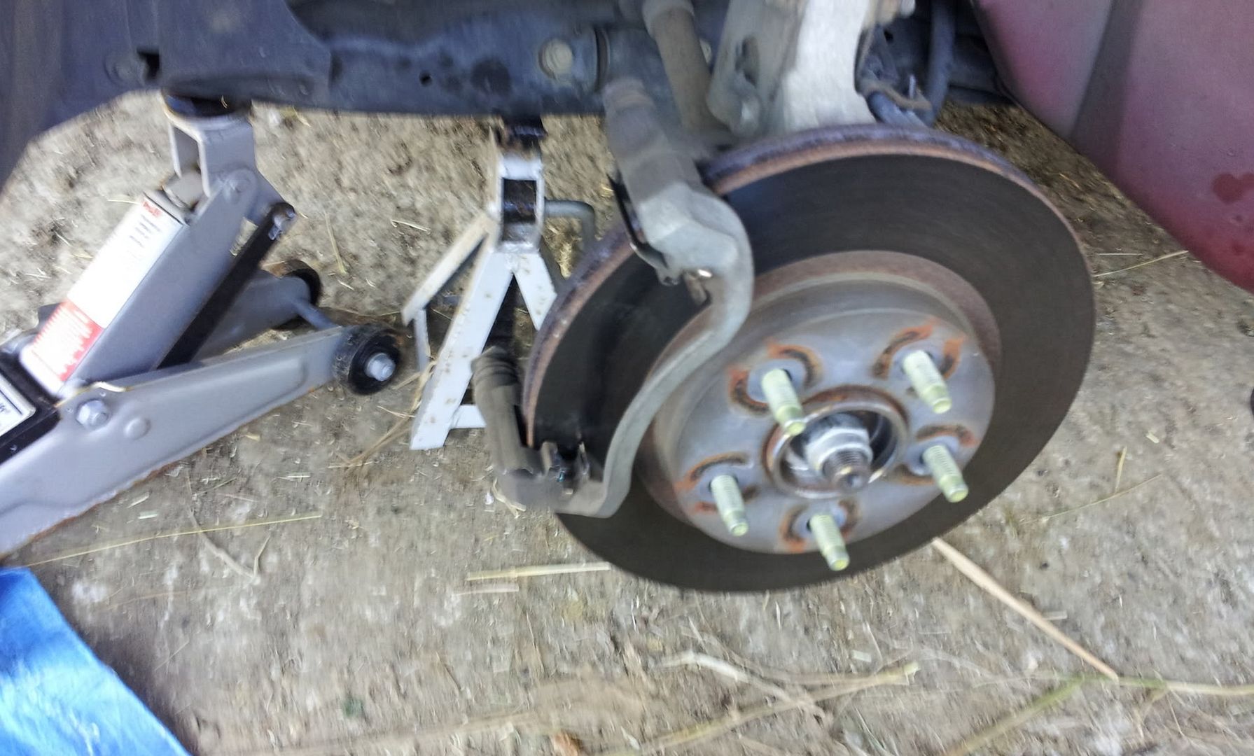

Jack and jack stand. I'm hoping this is the right area to jack up and use a jack stand.

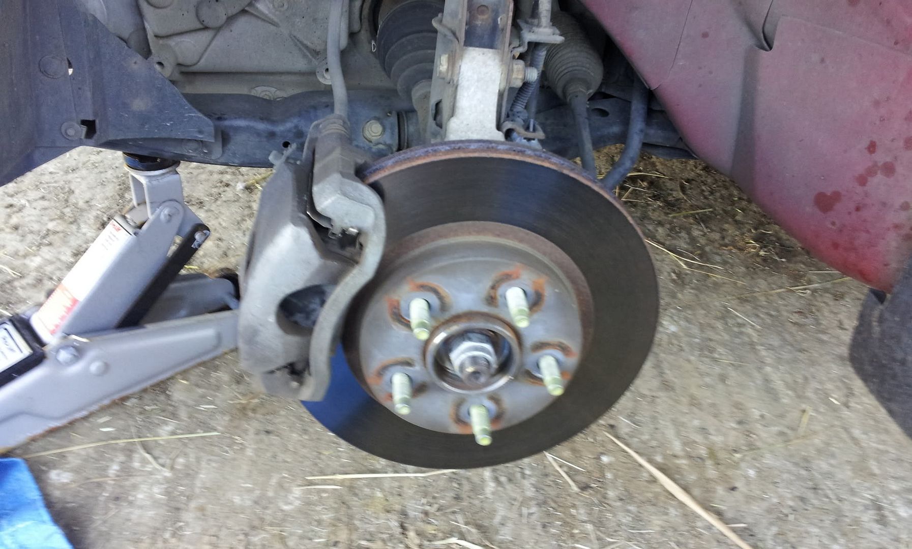

After taking the wheel off.

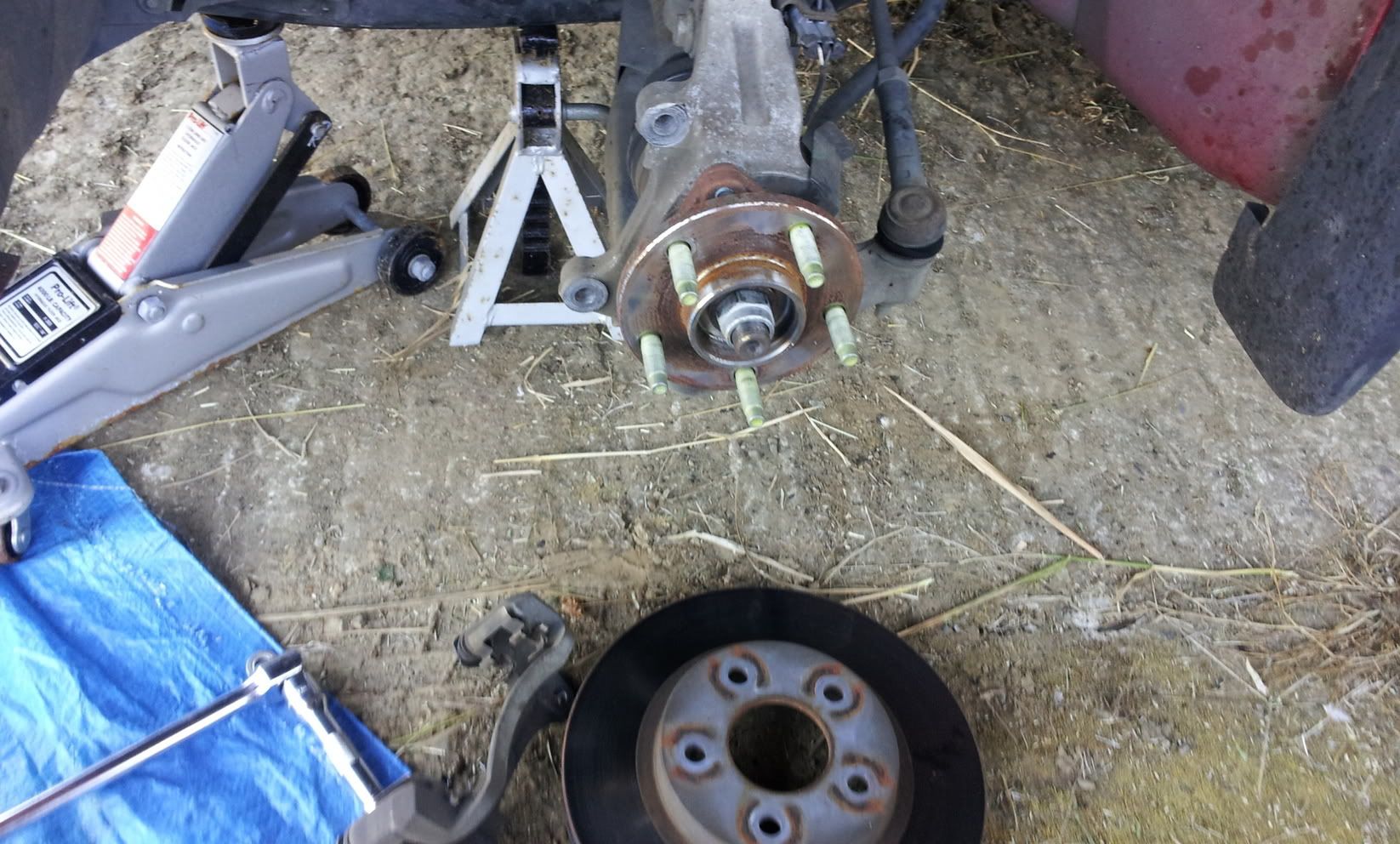

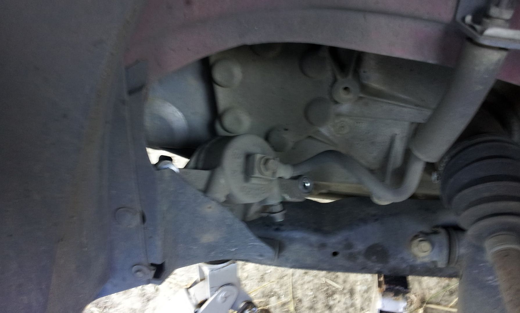

Nice place for the caliper. No coat hanger needed.

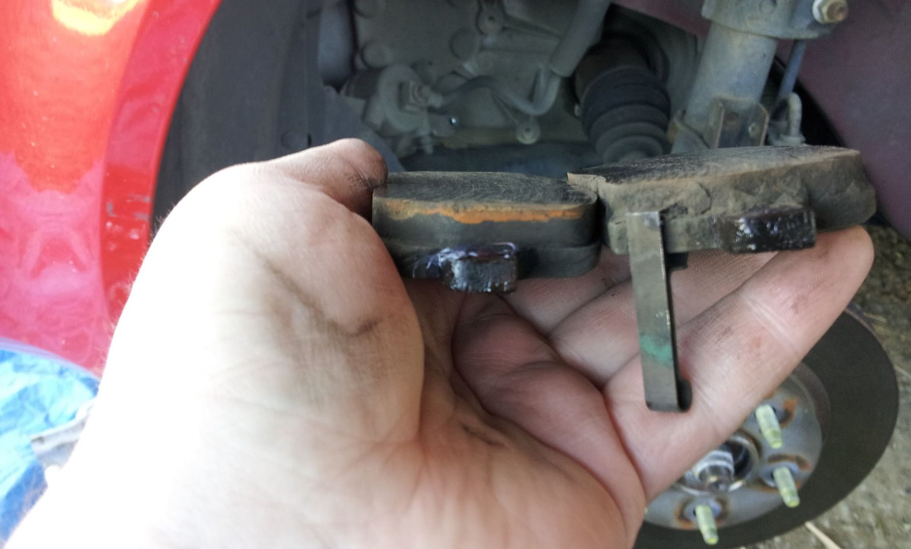

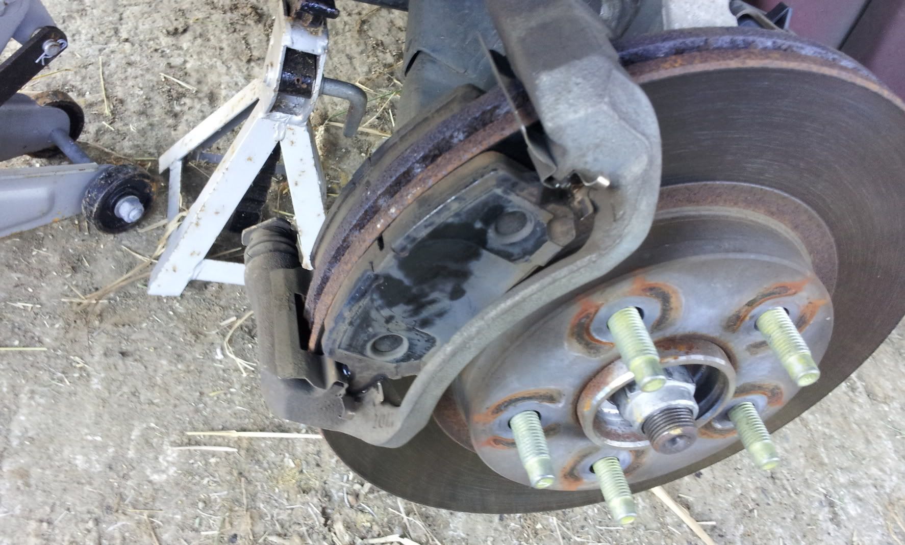

Old pads.
Showing how much pad is left. Again, not bad for 64,000 miles.

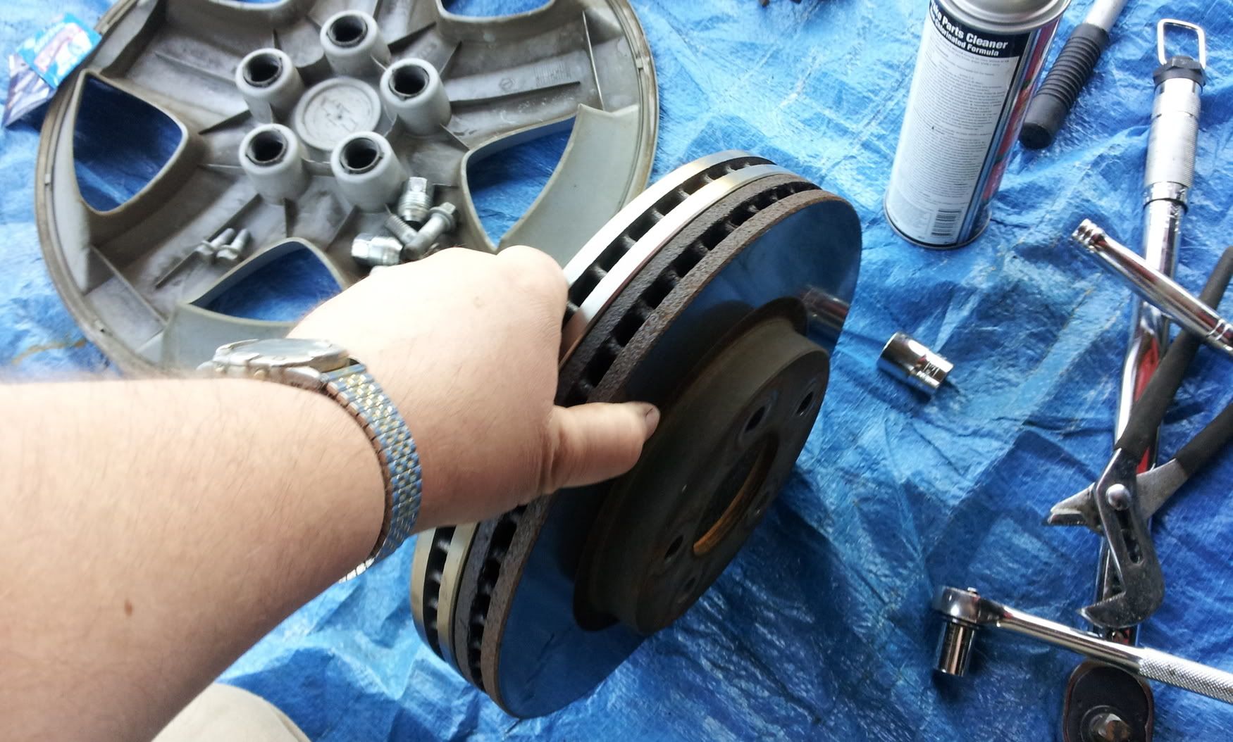

Making sure I have the right size rotors this time!!!

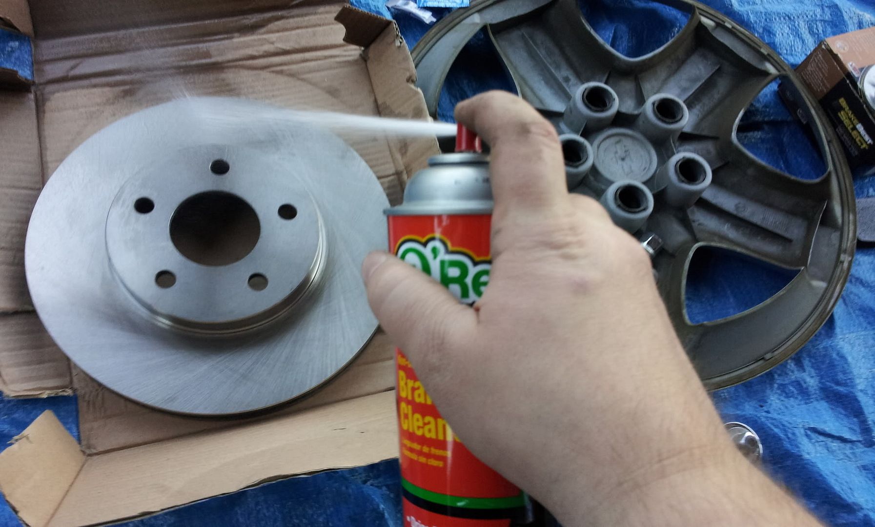

Cleaning off protective layer.

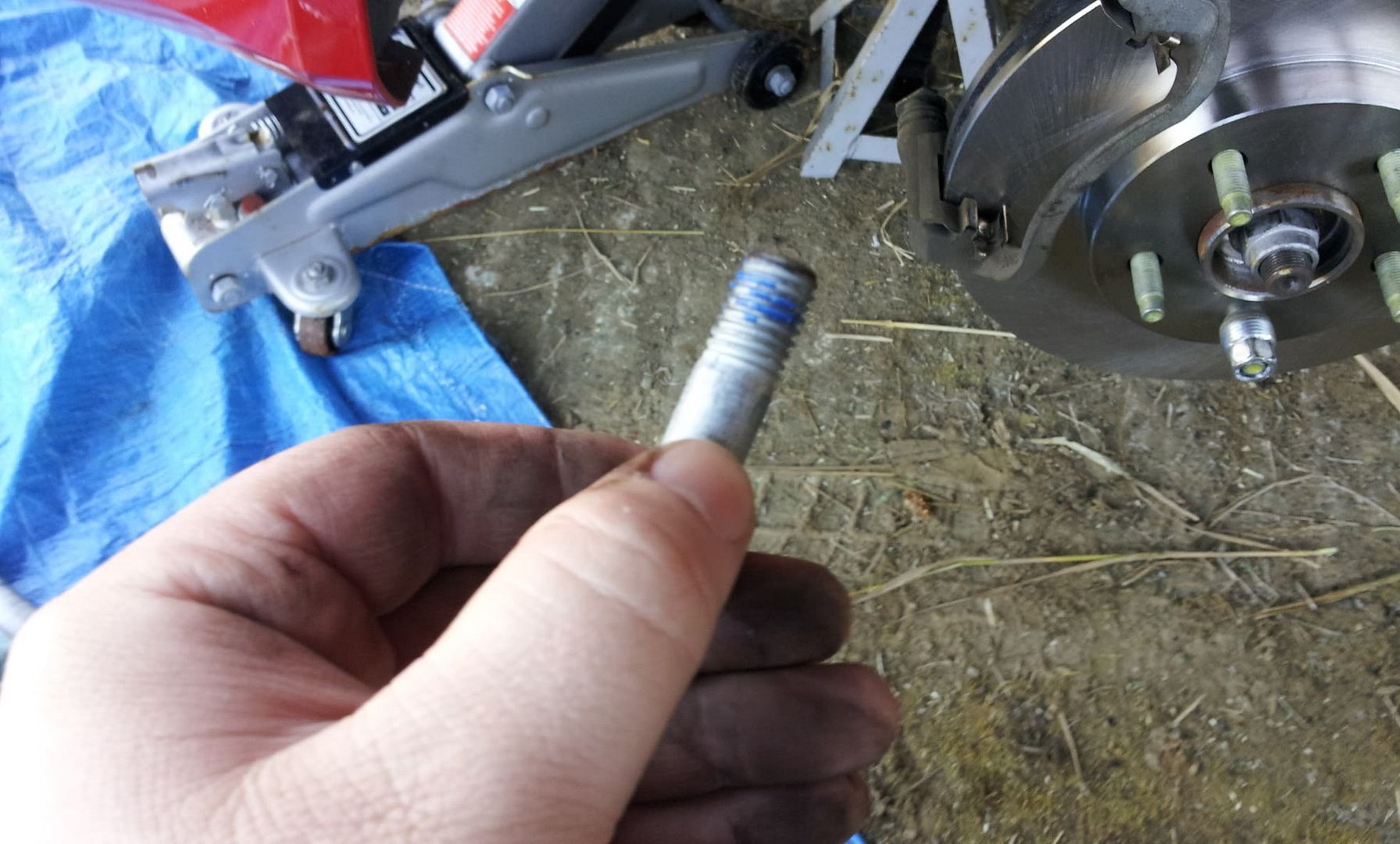

Thread lock.

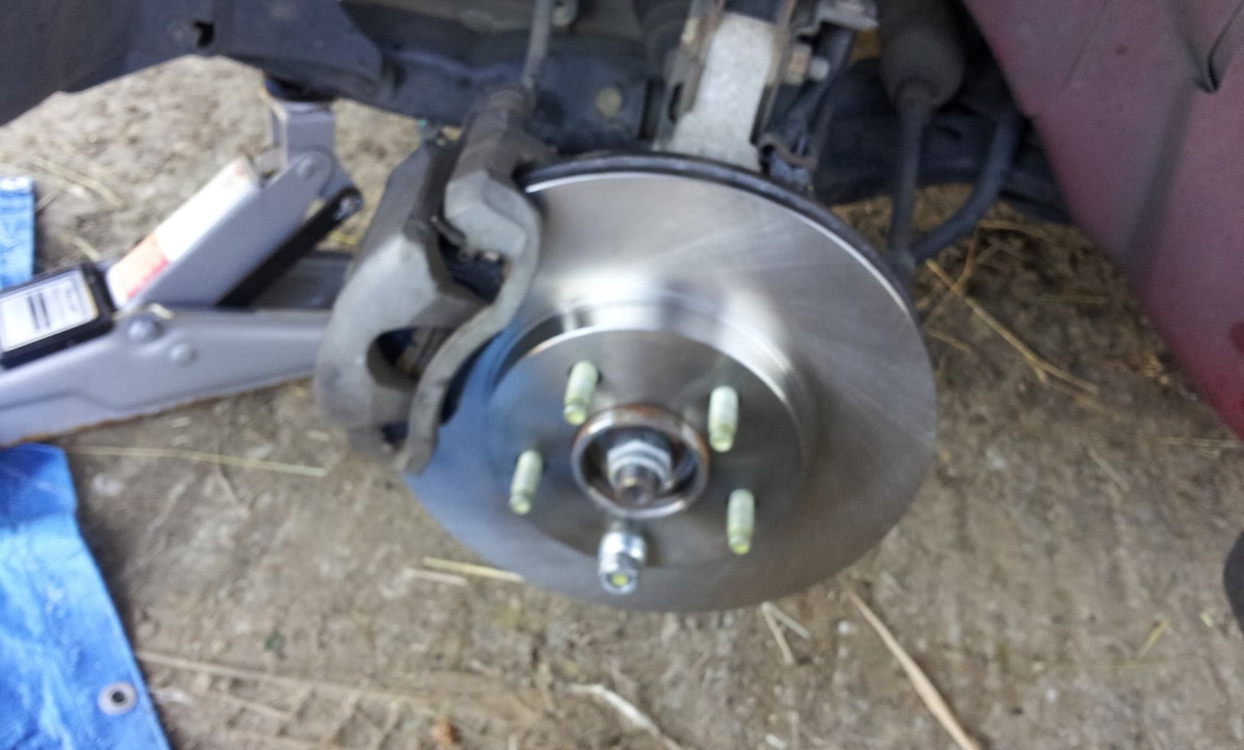

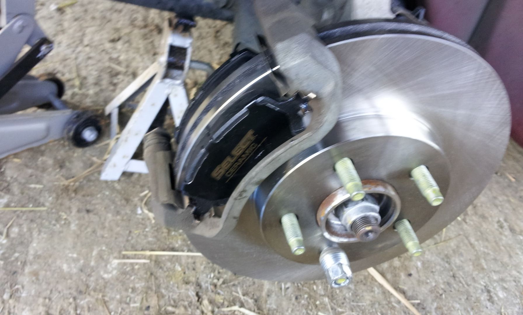

New pads installed.
Caliper reinstalled. Have to push the piston back in. I did it by hand since I didn't have a c-clamp. Just place one of the old pads on top of the piston and squeeze really hard. Also, don't forget to pump the brakes after you bolt the caliper back on or you're gonna have a bad time!!
All done! Other side is the same thing.

looks good, just a few questions. 1. Why and where did you use thread lock? 2. In the picture of your old pads, it looks like the pad with the wear sensor on it is worn way more than the other one, that being said, that is an indication that your caliper isn't floating on the glides properly, so just wondering if you cleaned up your guide pins and added a little antisieze to them? Other than that, great job! :)

I always use loctite on all of my suspension/brake parts.
That's the LAST thing you want coming loose in a caravan of cars going 90+mph for an event (ask my buddy Tony how he found out after swapping C5 Z06 calipers on his GTP back in '06...after it ruined the wheel, wheel bearing, and the caliper/rotor/pads :) ) is all of your brake setup.
And also "meh" @ the whole un-even pad wear...I've seen plenty of cars where the piston side gets more wear because of the instant pressure vs. the opposite side.
You would notice if the caliper was floating or hanging up...sluggish performance from the brake staying on, the wheel on the side where the caliper is hanging up will pull side to side on the highway, and you'd also notice a burning brake smell from rubbing for quite a while, not to mention the heat dissipation from them you can physically feel.

A properly torqued bolt should not need treadlock.
Uneven wear is a sign that your guide pins or pad seats need servicing.

I used the thread lock as a precautionary measure. I'm sure it would have been fine.
As for the caliper pins, I checked to make sure they were moving freely. I wasn't sure what kind of grease to use on them. Some say to use silicone grease, but I couldn't find that stuff anywhere. As for the uneven pad wear, I'm sure it's normal. It just has to do with the piston side getting instant pressure. I've seen the same on other cars too.
